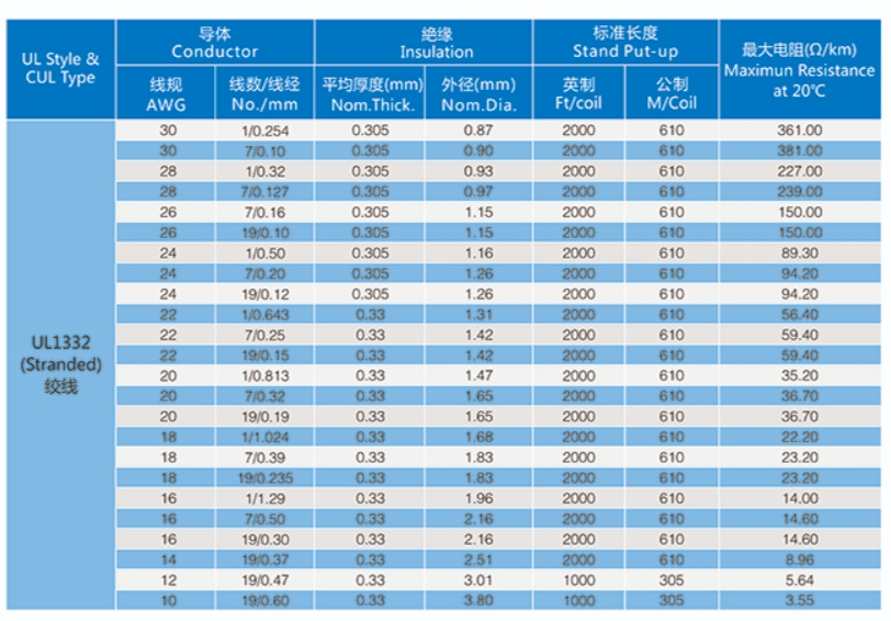

问下大家UL1332 28AWG的线OD都做多大?

<div id="OldPanel" style="WIDTH: 100%">
APPLIANCE WIRING MATERIAL
Subj.758Section 1Page 1332Issued:1963-02-04
Revised:2008-05-27
Style 1332Insulated Wire.
Rating200 deg C, 300 Vac, Horizontal flame, Oil Resistant 80 deg C (optional), Gasoline Resistant (opt)
Conductor30 AWG - 10 AWG solid or stranded round.
InsulationFEP, 13 mils min average, 12 mils minimum at any point.
Covering(Optional) FEP, 2 mils or heavier or glass braid 7 mils or heavier.
StandardAppliance Wiring Material UL 758.
MarkingGeneral.
UseInternal wiring of appliances. In addition, the tag may also indicate the following: Suitable for immersion in gasoline; gasoline vapor; 80 deg. C in oil; and or 600 volts peak for electronic use only.
UL and the UL Logo are trademarks of UL LLC © 2012 </div>
